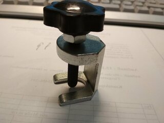

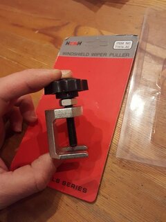

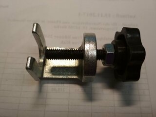

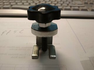

To demount the wiper arm you will need a tool:15098317183361138607908.jpgI bought this on Aliexpress for €3,30. Used it this year on my Dacia Logan MCV of 2008. The wiperarm was not damaged using this tool. I had rust round the wiper arm axle. I also had to treat the inside of the door. The inner lining of the door can be dismounted easy. With a brush I treated the inside of the door.
