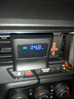

Hello! if the battery voltage drops, open the hood a little! after which you can close it in place! The ECU will increase the power generated by the alternator, and will give the battery a voltage of 14.8 volts charging all the way you will do after you open the hood!
