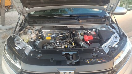

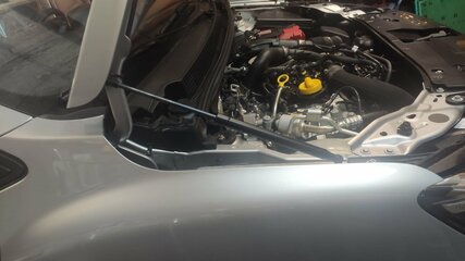

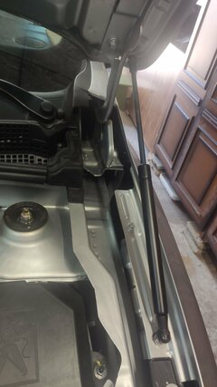

Hello everybody. I don't speak German, only a little English. I did the hood lifter. must be 40 or 41 cm long. These are aftermarket, from Alfa 156
