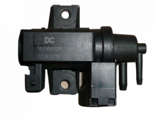

Years later, I came up with a definitive answer - turbo solenoid valve - 149564959R is the code.
This solenoid functioned poorly and, being vacuumatic, no error on the computer appeard. Basically, when gas pedal pressed, the computer orders this vacuum valve to modify turbo geometry. Mine was faulty since new and Dacia discovered the problem 2 months before 5 year warranty expired. They replaced the solenoid AND the turbo because, given the faulty sensor, the geometry stood almost always open and it was blocked like that, so no turbo for my car.
Simptoms - 1. from time to time acceleration was slow and not corresponding with the pressing of the gas pedal.
2. Poor milage - increased consumption
3. Poor engine break - going downhill without using brakes was an adventure.
4. A turbo whine when coasting, especially somewhere betweeen 90 and 120 kmh.
5. In fifth gear, when around 2000-2200 rpm a sudden "punch in the nose" of the car, a second of no acceleration, something like that, form time to time.
Hope it will help you.
Have a nice day!
